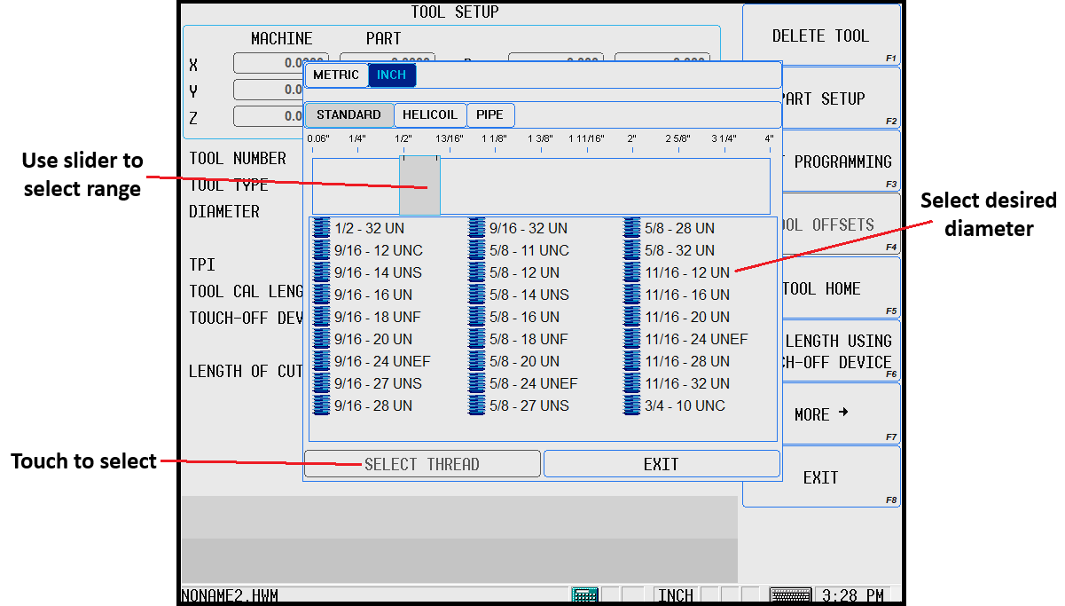

—in Tool Setup, appears when the tool type is Tap, Live Tap or Thread Mill (MC). Select the Tap icon, located to the right of the field. Choose the appropriate diameter from the pop-up box, as shown below:
